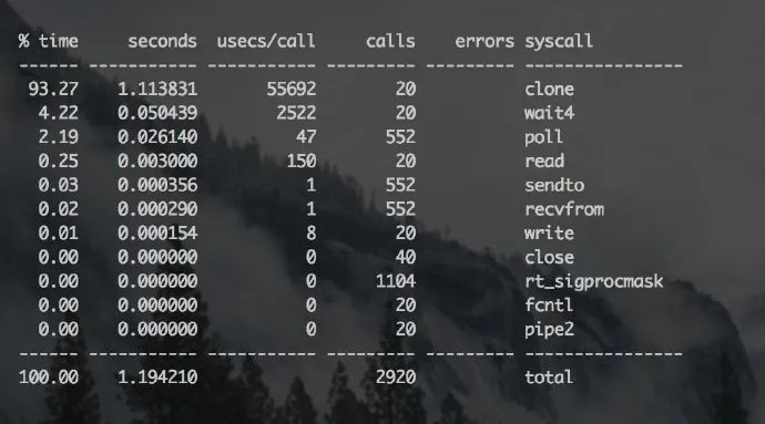

不过如果直接用 strace 跟踪某个进程的话,那么等待你的往往是满屏翻滚的字符,想从这里看出问题的症结并不是一件容易的事情,好在 strace 可以按操作汇总时间:
shell> strace -cp
通过「c」选项用来汇总各个操作的总耗时,运行后的结果大概如下图所示:

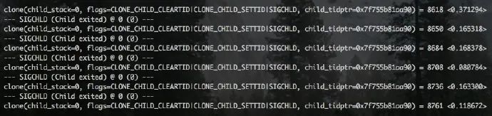

很明显,我们能看到 CPU 主要被 clone 操作消耗了,还可以单独跟踪一下 clone:
shell> strace -T -e clone -p
通过「T」选项可以获取操作实际消耗的时间,通过「e」选项可以跟踪某个操作:
很明显,一个 clone 操作需要几百毫秒,至于 clone 的含义,参考 man 文档:
clone() creates a new process, in a manner similar to fork(2). It is actually a library function layered on top of the underlying clone() system call, hereinafter referred to as sys_clone. A description of sys_clone is given towards the end of this page.
Unlike fork(2), these calls allow the child process to share parts of its execution context with the calling process, such as the memory space, the table of file descriptors, and the table of signal handlers. (Note that on this manual page, “calling process” normally corresponds to “parent process”. But see the description of CLONE_PARENT below.)
简单来说,就是创建一个新进程。那么在 PHP 里什么时候会出现此类系统调用呢?查询业务代码看到了 exec 函数,通过如下命令验证它确实会导致 clone 系统调用:
shell> strace -eclone php -r 'exec("ls");
