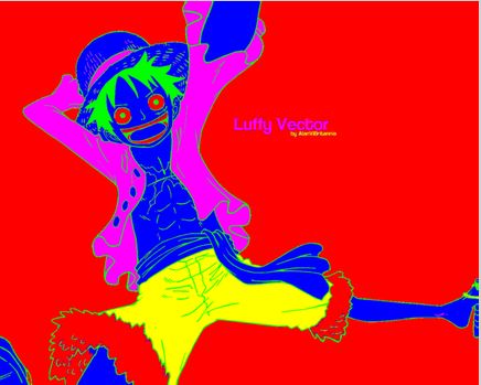

分类代码:
#include
#include
using namespace cv;
using namespace std;
RNG rng(12345);
const int Max_nCluster = 5;
int main(int argc, char** argv) {
//Mat img(500, 500, CV_8UC3);
Mat inputImage = imread("1.jpg");
assert(!inputImage.data);
Scalar colorTab[] = {
Scalar(0, 0, 255),
Scalar(0, 255, 0),
Scalar(255, 0, 0),
Scalar(0, 255, 255),
Scalar(255, 0, 255)
Mat matData = Mat::zeros(Size(inputImage.channels(), inputImage.rows*inputImage.cols), CV_32FC1);
int ncluster = 5; //rng.uniform(2, Max_nCluster + 1);//聚类数量
Mat label;//聚类标签
Mat centers(ncluster, 1, matData.type());
for (size_t i = 0; i < inputImage.rows; i++)//把图像存储到样本容器
uchar* ptr = inputImage.ptr(i);
for (size_t j = 0; j < inputImage.cols; j++)
matData.at(i*inputImage.cols + j, 0) = ptr[j*inputImage.channels()];
matData.at(i*inputImage.cols + j, 1) = ptr[j*inputImage.channels() +1];
matData.at(i*inputImage.cols + j, 2) = ptr[j*inputImage.channels() +2];
Mat result = Mat::zeros(inputImage.size(), inputImage.type());
TermCriteria criteria = TermCriteria(TermCriteria::EPS + TermCriteria::COUNT, 20, 0.1);
kmeans(matData, ncluster, label, criteria, 3, KMEANS_PP_CENTERS, centers);
for (size_t j = 0; j < inputImage.cols; j ++)
int index = label.at(i*inputImage.cols + j,0);
result.at(i, j)[0] = colorTab[index][0];
result.at(i, j)[1] = colorTab[index][1];
result.at(i, j)[2] = colorTab[index][2];
imshow("12", result);
waitKey(0);
return 0;
