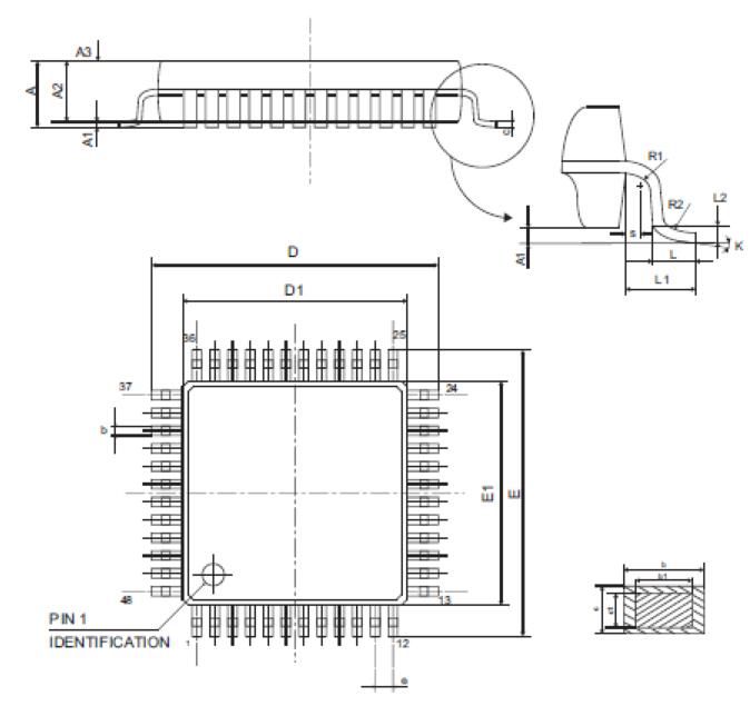

封装LQFP48

灵动微MM32L073系列型号表
Series CPU Core Part Number Package Flash RAM Max. Speed GPIO USB 2.0FS 12b ADC
MM32L Cortex-M0 MM32L073TW TSSOP20 128KB 8KB 48MHz 16 Dev. 9
MM32L Cortex-M0 MM32L073NT QFN32 128KB 8KB 48MHz 27 Dev. 10
MM32L Cortex-M0 MM32L073PT LQFP32 128KB 8KB 48MHz 25 Dev. 10
MM32L Cortex-M0 MM32L073PF LQFP48 128KB 8KB 48MHz 39 Dev. 10
