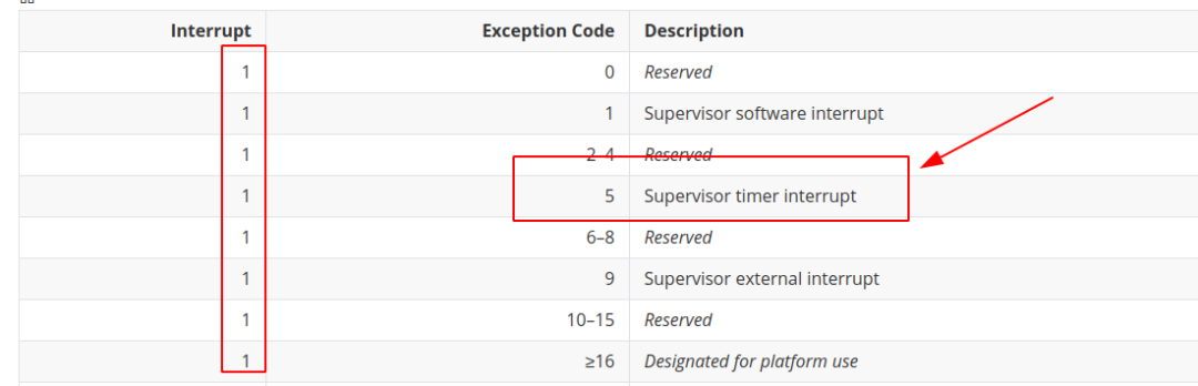

该寄存器表示中断发生的原因。下面的表格中表述了中断的发生原因:
Interrupt Exception Code Description
1 0 Reserved
1 1 Supervisor software interrupt
1 2–4 Reserved
1 5 Supervisor timer interrupt
1 6–8 Reserved
1 9 Supervisor external interrupt
1 10–15 Reserved
1 ≥16 Designated for platform use
0 0 Instruction address misaligned
0 1 Instruction access fault
0 2 Illegal instruction
0 3 Breakpoint
0 4 Load address misaligned
0 5 Load access fault
0 6 Store/AMO address misaligned
0 7 Store/AMO access fault
0 8 Environment call from U-mode
0 9 Environment call from S-mode
0 10–11 Reserved
0 12 Instruction page fault
0 13 Load page fault
0 14 Reserved
0 15 Store/AMO page fault
0 16–23 Reserved
0 24–31 Designated for custom use
0 32–47 Reserved
0 48–63 Designated for custom use
0 ≥64 Reserved

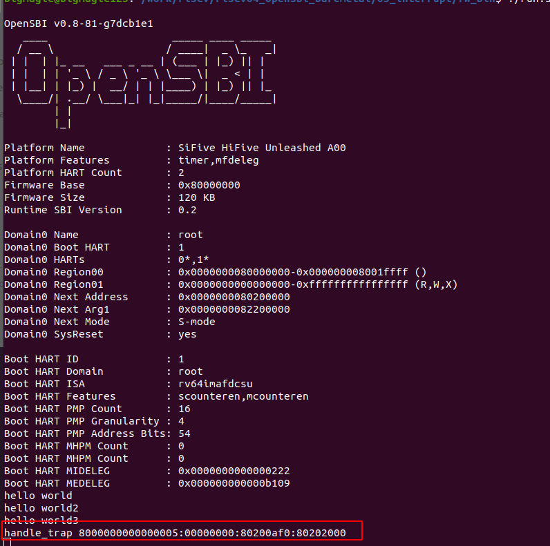

uintptr_t handle_trap(uintptr_t scause, uintptr_t stval, uintptr_t sepc, uintptr_t sp) {     tfp_printf("handle_trap %08lx:%08lx:%08lx:%08lx ", scause, stval, sepc, sp);     while (1);     return 0; }
4.测试及校验
因为工程文件的增加,所以使用了Makefile进行工程的构建工作。
%.o: %.c %.s         $(CC) $(CFLAGS) -c $< -o $@
Makefile的语法规则基本
TARGET … : DEPENDENCIES …   COMMAND
这里也不过多的涉及了。
输入make后,在fw_bin目录下执行run.sh脚本即可。
最后可以看到中断的原因
最高位是8,相应的中断描述为Supervisor timer interrupt。
