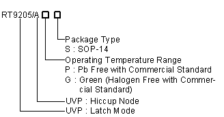

Ordering Info
Controller
Note :
Richtek Pb-free and Green products are :
► RoHS compliant and compatible with the current require-
ments of IPC/JEDEC J-STD-020.
► Suitable for use in SnPb or Pb-free soldering processes.

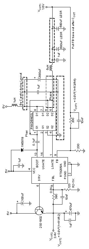

Typical Applications Circuit
Controller
Figure 1. RT9205/A powered form 5V

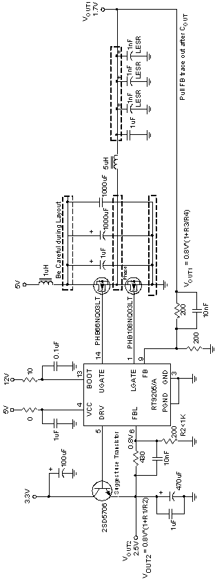

Controller
Figure 2. RT9205/A powered from 12V

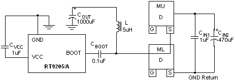

Layout Placement
Layout Notes
1. Put C1 & C2 to be near the MU drain and ML source nodes.
2. Put RT9205/A to be near the COUT
3. Put CBOOT as close as to BOOT pin
4. Put CVCC as close as to VCC pin
