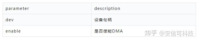

bflb_dac_link_txdma
说明: dac dma 开关使能
void bflb_dac_link_txdma(struct bflb_device_s *dev, bool enable);

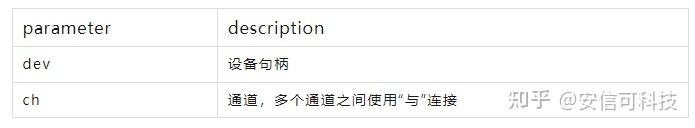

bflb_dac_channel_enable
说明: dac 通道使能。
void bflb_dac_channel_enable(struct bflb_device_s *dev, uint8_t ch);
dac
bflb_dac_channel_disable
说明: dac 通道关闭。
void bflb_dac_channel_disable(struct bflb_device_s *dev, uint8_t ch);

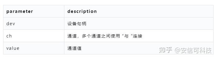

bflb_dac_set_value
说明: 更改 dac 通道值。
void bflb_dac_set_value(struct bflb_device_s *dev, uint8_t ch, uint16_t value);
