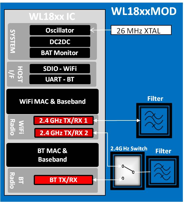

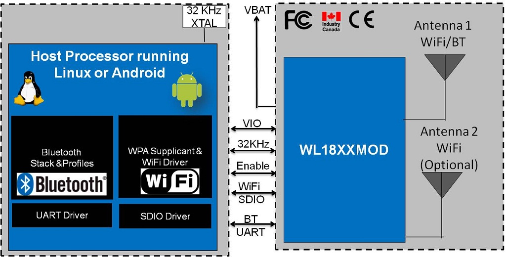

参数 与其它产品相比 Wi-Fi
Device Type
Flash (KB)
Throughput (Max) (Mbps)
Features
Operating Temperature Range (C)
Certifications
Package (mm)
WL1805MOD WL1801MOD WL1807MOD WL1831MOD WL1835MOD WL1837MOD
Module
Smart RF Transceiver
Module
Smart RF Transceiver     Module
Module
Module
N/A     N/A     N/A     N/A     N/A     N/A
100     100     100     100     100     100
802.11bgn
2x2 MIMO
AP
STA
Wi-Fi Direct Mode
Mesh over Wi-Fi based on 802.11s
802.11bgn
AP
STA
Wi-Fi Direct Mode
802.11abgn
2x2 MIMO
AP
STA
Wi-Fi Direct Mode
802.11bgn
Bluetooth 4.2
AP
STA
Wi-Fi Direct Mode
802.11bgn
Bluetooth 4.2
2x2 MIMO
AP
STA
Wi-Fi Direct Mode
02.11abgn
Bluetooth 4.2
2x2 MIMO
AP
STA
Wi-Fi Direct Mode
-20 to 70     -20 to 70     -40 to 85     -20 to 70     -20 to 70     -40 to 85
FCC, IC, ETSI/CE, and TELEC     FCC, IC, ETSI/CE, and TELEC     FCC, IC, ETSI/CE, and TELEC     FCC, IC, ETSI/CE, and TELEC     FCC, IC, ETSI/CE, and TELEC     FCC, IC, ETSI/CE, and TELEC
MOC (100 pin LGA Module)     MOC (100 pin LGA Module)     MOC (100 pin LGA Module)     MOC (100 pin LGA Module)     MOC (100 pin LGA Module)     MOC (100 pin LGA Module)
