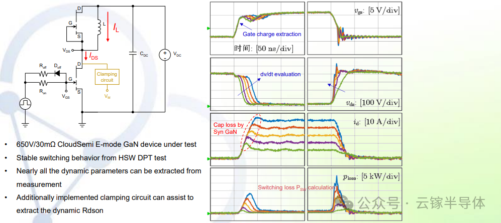

An example of DPT -650V/30mΩ CloudSemi GaN
功率器件

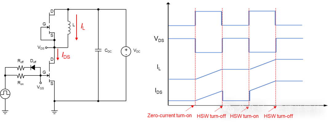

1st pulse turn-on: zero-current switching
功率器件

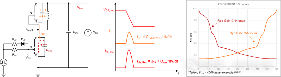

Stageof start-up,zero-current turn-on (capacitive-load switching):
  • Vds of rectifier GaN: Vbus→ 0; Vds of synchronous GaN: 0 → Vbus
  • The setup can be treated as a capacitive-load switching:
  • Oscilloscope-captured Ids comes from charging Coss of Syn GaN: Ids = C(Vbus-Vds)*dv/dt
  • Discharging Coss of Rec GaN cannot be directly captured by oscilloscope: ICoss= Coss*dv/dt
  • Current through Rec GaN channel: Ich, rec = Ids + Coss*dv/dt

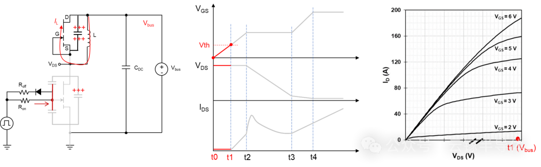

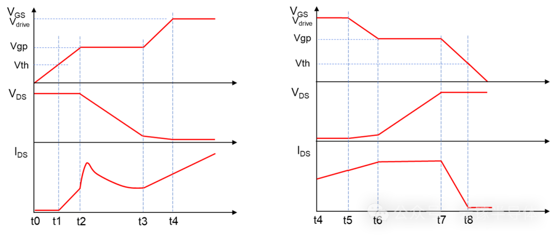

t0~t1,gate drive charges Ciss of Rec GaN:
Vgs of Rec GaN rises to Vth. No current flows through Rec GaN.
Load current flows through inductor and Syn GaN.
Until Vgs of Rec GaN reach to its Vth, load current starts to commutate and flow through it.

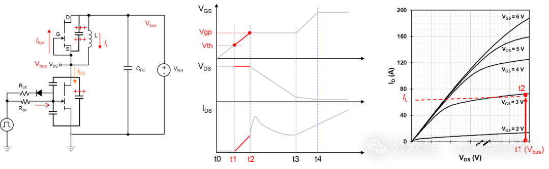

03
HSW turn-on transient: current commutation
功率器件
t1~t2,current commutation:
As Vgs of Rec GaN reaches Vth,current starts to flow through Rec GaN. Load current gradually commutates from Syn GaN to Rec GaN, as Vgs increases;
During current commutation, the gate driver charges Ciss until Rec GaN has currentcapability of IL.[Ids|(Vgs=Vgp) = IL]
When Vgs = Vgp (Miller plateau, = Vth + IL/gm),all the inductive-load current flows through the Rec GaN.
In this duration, Rec GaN Ids overlaps with Vds, and I-Voverlap loss dominates and can be calculated by integrating I&V.
04
HSW turn-on transient: voltage commutation
功率器件

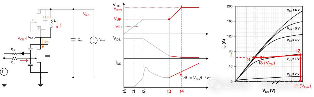

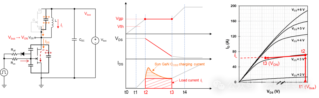

t2~t3,voltage commutation:
As Vgs of Rec GaN reaches Vgp, allthe load current flows through Rec GaN;
Then, RecGaN Coss starts to discharge from Vbus to Von & SynGaN Coss starts to charge to Vbus
RecGaN Coss discharging cannot be captured,but SynGaN Coss charging can be recognized from Ids waveform
During this duration, the loss on Rec GaN consists of 2main parts:
I-V overlap loss
Cap loss from Syn/Rec GaN: Vbus*Qoss

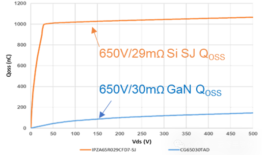

功率器件
GaN features much lower Qoss and switching loss Psw comparing to Si SJ
05
HSW turn-on transient: gate over-drive
功率器件
t3~t4,gate over-drive to make GaN fully turn-on:

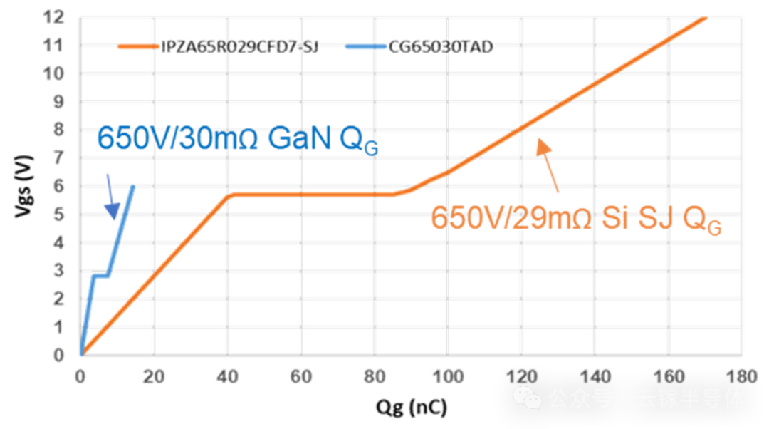

Gatedriver continue to charge Ciss from Vgp to Vdrive (e.g. 6V), making GaN FET fullyturn-on
Von= IL* Rdson (Vgs = Vdrive). Therecommended gate drive voltage for CloudSemi E-mode GaN is ~6.0V.
Aftert4, inductive load will continue to excite, following dIL = Vbus/L * dt
Conductionloss on Rec GaN FET dominates in this duration
Comparing to Si SJ, GaN FET features much lower gate charge QG
功率器件
06
Turn-on period: excitation
功率器件
t4~t5,inductive load excitation:
dIL = Vbus/L *dt, Ids = IL
Ciss stops charging
Currentflowing through GaN channel gradually increases
RecGaN FET works in linear region.

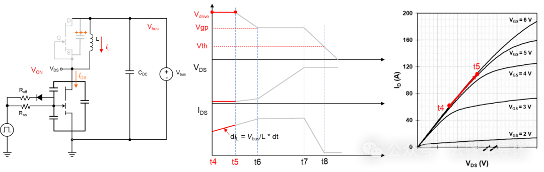

07
HSW turn-off transient: VGS → Vgp
功率器件

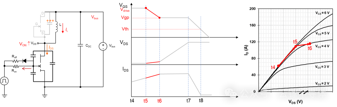

t5~t6, Ciss starts discharging:
Rec GaN Ciss starts to discharge, until GaN enters saturation mode (Vgs = Vgp, Idsat = IL).
Here,Vgp =Vth + IL/gm
RecGaN works from linear region to saturation region
08
HSW turn-off transient: voltage commutation
功率器件

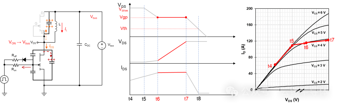

t6~t7,voltage commutation (Rec GaN Vds rises to Vbus):
Loadcurrent charges the switching node (charging Coss ofRec GaN, discharging Coss of Syn GaN)
Parameterof Qoss is crucial, and determinescharging/discharging speed (i.e. switching speed)
Powerloss on Rec GaN mainly comes from I-V overlap loss
09
HSW turn-off transient: current commutation
功率器件

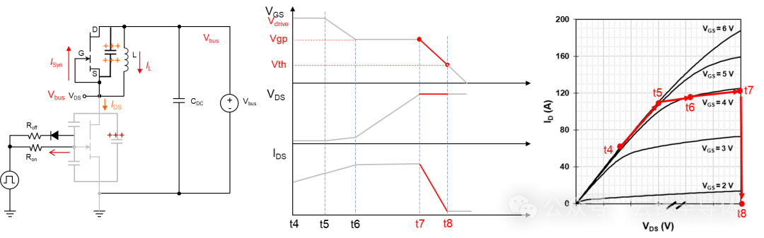

t7~t8,current commutation:
Load current gradually commutates from Rec GaN to Syn GaN, as Vgs decreases;
Duringcurrent commutation, the gate driver discharges Ciss until Rec GaN has been turned off(Vgs = Vth)
WhenRec GaN Vgs = Vth (i.e. after t8), all the inductive-load current flows through theSyn GaN.
Powerloss mainly comes from I-V overlap loss

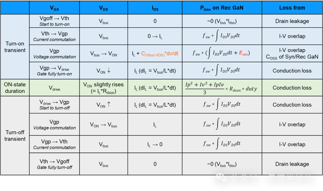

Part 3 : Summary
01
Summary
功率器件
功率器件
