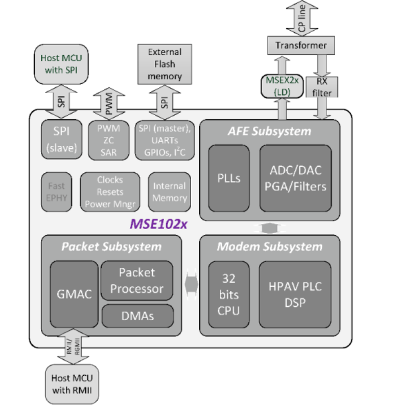

MSE102x芯片介绍
联芯通MSE102x系列芯片是一款专注于电动汽车充电通信和智能能源管理的GreenPHY电力线载波通信芯片,MSE102x支持RMII和SPI两种主机接口,可根据具体应用场景灵活选择。本文主要介绍如何基于RMII和SPI两种不同的接口方式来驱动MSE102x。
米尔电子
MSE102x系统框图

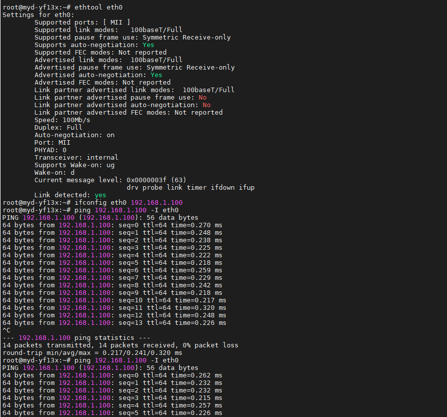

方案一:RMII接口调试
硬件连接:
MSE102x通过RMII接口与米尔核心板MYC-YF13X的ETH1控制器连接,实现MAC层直接通信。

1、设备树的修改
PC:~/myir-st-linux$ vi arch/arm/boot/dts/myb-stm32mp135x-base.dtsið1 {status = "okay";pinctrl-0 = <ð1_rmii_pins_a>;pinctrl-1 = <ð1_rmii_sleep_pins_a>;pinctrl-names = "default", "sleep";phy-mode = "rmii";max-speed = <100>;nvmem-cells = <ðernet_mac1_address>;nvmem-cell-names = "mac-address";st,ext-phyclk;mdio1 {#address-cells = <1>;#size-cells = <0>;compatible = "snps,dwmac-mdio";};fixed-link {speed = <100>;full-duplex;};};
2、引脚复用配置
PC:~/myir-st-linux$ vi arch/arm/boot/dts/myb-stm32mp13-pinctrl.dtsieth1_rmii_pins_a: eth1-rmii-1 {pins1 {pinmux = 'G', 13, AF11)>, /* ETH_RMII_TXD0 */'G', 14, AF11)>, /* ETH_RMII_TXD1 */'A', 11, AF11)>, /* ETH_RMII_ETHCK */'B', 11, AF11)>, /* ETH_RMII_TX_EN */'A', 2, AF11)>, /* ETH_MDIO */'G', 2, AF11)>; /* ETH_MDC */bias-disable;drive-push-pull;slew-rate = <1>;};pins2 {pinmux = 'C', 4, AF11)>, /* ETH_RMII_RXD0 */'C', 5, AF11)>, /* ETH_RMII_RXD1 */'A', 7, AF11)>; /* ETH_RMII_CRS_DV */bias-disable;};};eth1_rmii_sleep_pins_a: eth1-rmii-sleep-1 {pins1 {pinmux = 'G', 13, AF11)>, /* ETH_RMII_TXD0 */'G', 14, AF11)>, /* ETH_RMII_TXD1 */'B', 11, AF11)>, /* ETH_RMII_TX_EN */'A', 11, AF11)>, /* ETH_RMII_ETHCK */'A', 2, AF11)>, /* ETH_MDIO */'G', 2, AF11)>, /* ETH_MDC */'C', 4, AF11)>, /* ETH_RMII_RXD0 */'C', 5, AF11)>, /* ETH_RMII_RXD1 */'A', 7, AF11)>; /* ETH_RMII_CRS_DV */};};
测试结果:
系统成功识别eth1网络设备,可通过标准网络工具进行通信测试,为V2G通信提供稳定的网络基础。

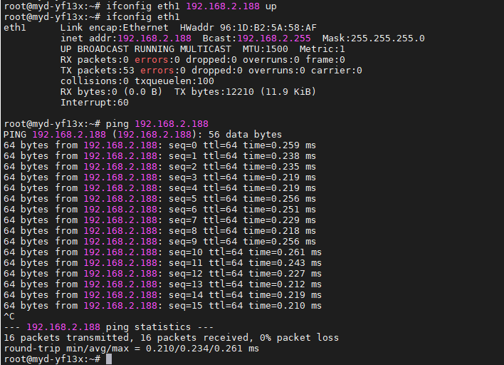

方案二:SPI接口调试
硬件连接:
MSE102x作为SPI从设备连接到米尔核心板MYC-YF13X的SPI1接口,适用于需要灵活布板的场景。
软件配置关键步骤:
1、SPI设备树配置
PC:~/myir-st-linux$ vi arch/arm/boot/dts/myb-stm32mp135x-base.dtsi............&spi1 {pinctrl-names = "default", "sleep";pinctrl-0 = <&spi1_pins_a>;pinctrl-1 = <&spi1_sleep_pins_a>;cs-gpios = <&gpioa 4 0>;status = "okay";mse102x@0 {compatible = "vertexcom,mse1021";reg = <0>;interrupt-parent = <&gpioi>;interrupts = <1 IRQ_TYPE_EDGE_RISING>;spi-cpha;spi-cpol;spi-max-frequency = <7142857>;};};
2、SPI引脚的配置
PC:~/myir-st-linux$ vi arch/arm/boot/dts/myb-stm32mp13-pinctrl.dtsi............spi1_pins_a: spi1-0 {pins1 {pinmux = , /* SPI1_SCK */; /* SPI1_MOSI */bias-disable;drive-push-pull;slew-rate = <1>;};pins2 {pinmux = ; /* SPI1_MISO */bias-disable;};};spi1_sleep_pins_a: spi1-sleep-0 {pins {pinmux = , /* SPI1_SCK */, /* SPI1_MISO */; /* SPI1_MOSI */};};
测试结果:
系统启动时正确识别MSE102x设备,生成对应的网络接口,可通过PLC链路建立V2G通信连接。
