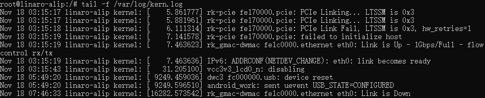

•查看持久化日志文件:多数发行版会将内核日志写入/var/log/kern.log,可用tail 实时跟踪:
L
