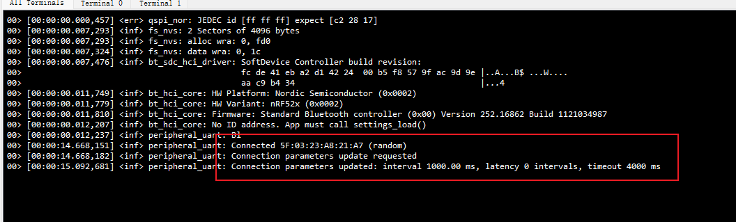

设置连接,并且通过连接回调打印
主要需要添加CONFIG_FPU=y这个宏,才能打印浮点数
//设置更新参数回调
void on_le_param_updated(struct bt_conn *conn, uint16_t interval, uint16_t latency, uint16_t timeout)
    double connection_interval = interval*1.25;         // in ms
    uint16_t supervision_timeout = timeout*10;          // in ms
    LOG_INF("Connection parameters updated: interval %.2f ms, latency %d intervals, timeout %d ms", connection_interval, latency, supervision_timeout);

打印的LOG
