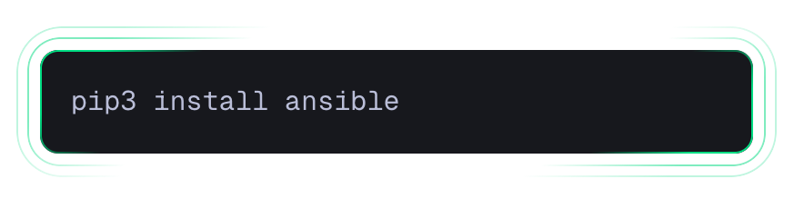

1.在服务器上安装 Ansible
pip3 install ansible

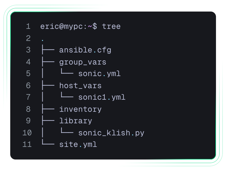

我们所提供的demo文件结构如下
eric@mypc:~$ tree . ├── ansible.cfg ├── group_vars │ └── sonic.yml ├── host_vars │ └── sonic1.yml ├── inventory ├── library │ └── sonic_klish.py └── site.yml

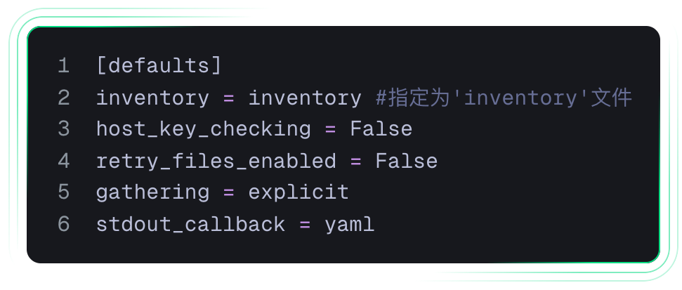

2.在 ansible.cfg 中指定设备信息文件
[defaults] inventory = inventory #指定为'inventory'文件 host_key_checking = False retry_files_enabled = False gathering = explicit stdout_callback = yaml

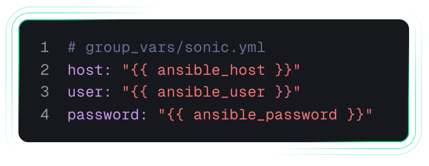

4.group_vars/sonic.yml 文件不需要改动
# group_vars/sonic.yml host: "{{ ansible_host }}" user: "{{ ansible_user }}" password: "{{ ansible_password }}"

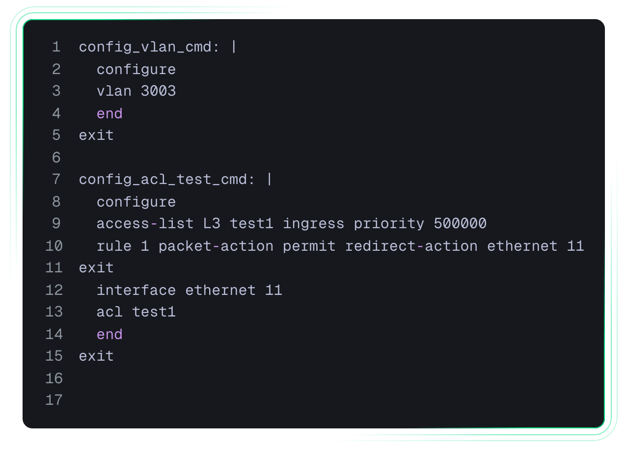

5.host_vars/sonic1.yml 中编写要下发的配置
以下为两组示例的命令行配置
config_vlan_cmd: | configure vlan 3003 end exit config_acl_test_cmd: | configure access-list L3 test1 ingress priority 500000 rule 1 packet-action permit redirect-action ethernet 11 exit interface ethernet 11 acl test1 end exit

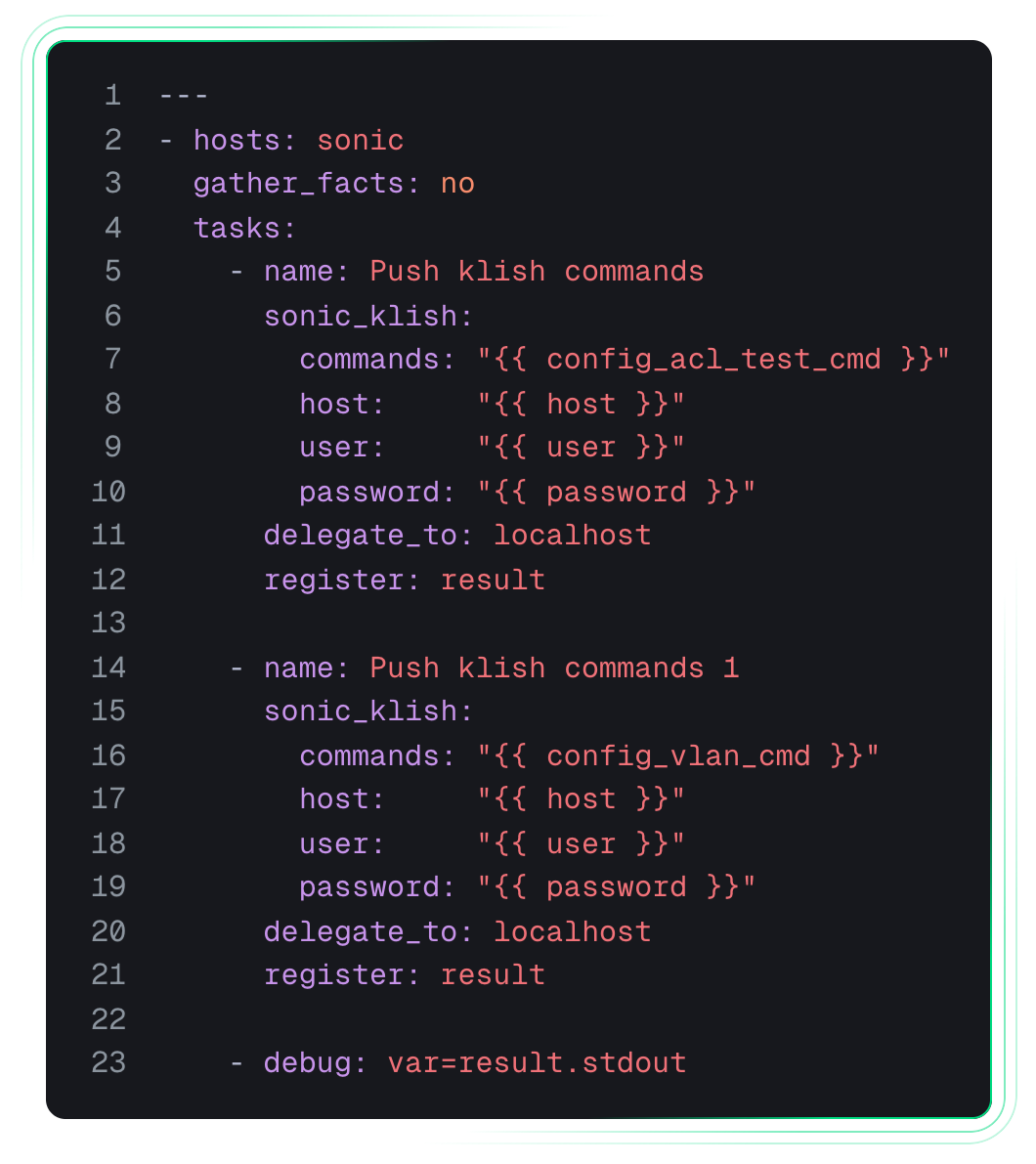

7、site.yml 设置用例
新增两个task分别调用config_acl_test_cmd和config_vlan_cmd
--- - hosts: sonic gather_facts: no tasks: - name: Push klish commands sonic_klish: commands: "{{ config_acl_test_cmd }}" host: "{{ host }}" user: "{{ user }}" password: "{{ password }}" delegate_to: localhost register: result - name: Push klish commands 1 sonic_klish: commands: "{{ config_vlan_cmd }}" host: "{{ host }}" user: "{{ user }}" password: "{{ password }}" delegate_to: localhost register: result - debug: var=result.stdout

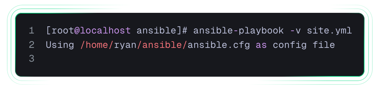

8.执行用例
[root@localhost ansible]# ansible-playbook -v site.yml Using /home/ryan/ansible/ansible.cfg as config file
打印如下,则执行完毕:
PLAY [sonic] ********************* TASK [Push klish commands] **************** changed: [sonic1 -> localhost] => changed=true stdout: |- Warning: Permanently added '192.168.1.102' (RSA) to the list of known hosts. ...Entering cli view, please wait... stty: 'standard input': Inappropriate ioctl for device stty: 'standard input': Inappropriate ioctl for device sonic# configure sonic(config)# access-list L3 test1 ingress priority 500000 sonic(config-L3-acl-test1)# rule 1 packet-action permit redirect-action ethernet 13 sonic(config-L3-acl-test1)# exit[J sonic(config)# interface ethernet 13 sonic(config-if-13)# acl test1[J sonic(config-if-13)# end[J sonic# exit stdout_lines: TASK [debug] *********************** ok: [sonic1] => result.stdout: |- Warning: Permanently added '192.168.1.102' (RSA) to the list of known hosts. ...Entering cli view, please wait... stty: 'standard input': Inappropriate ioctl for device stty: 'standard input': Inappropriate ioctl for device sonic# configure sonic(config)# access-list L3 test1 ingress priority 500000 sonic(config-L3-acl-test1)# rule 1 packet-action permit redirect-action ethernet 13 sonic(config-L3-acl-test1)# exit[J sonic(config)# interface ethernet 13 sonic(config-if-13)# acl test1[J sonic(config-if-13)# end[J sonic# exit TASK [Push klish commands] ***************** changed: [sonic1 -> localhost] => changed=true stdout: |- Warning: Permanently added '192.168.1.102' (RSA) to the list of known hosts. ...Entering cli view, please wait... stty: 'standard input': Inappropriate ioctl for device stty: 'standard input': Inappropriate ioctl for device sonic# configure sonic(config)# vlan 3003 sonic(config-vlan-3003)# end[J sonic# exit stdout_lines: TASK [debug] ********************* ok: [sonic1] => result.stdout: |- Warning: Permanently added '192.168.1.102' (RSA) to the list of known hosts. ...Entering cli view, please wait... stty: 'standard input': Inappropriate ioctl for device stty: 'standard input': Inappropriate ioctl for device sonic# configure sonic(config)# vlan 3003 sonic(config-vlan-3003)# end[J sonic# exit PLAY RECAP ************************ sonic1 : ok=4 changed=2 unreachable=0 failed=0 skipped=0 rescued=0 ignored=0
