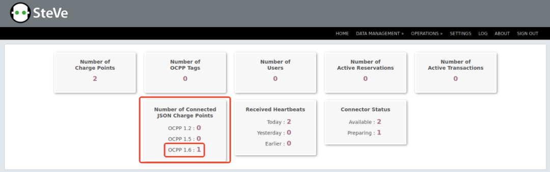

部署完成后,客户端成功与SteVe服务器建立WebSocket连接:
root@myd-yf13x:~/Microocpp# export LD_LIBRARY_PATH=/home/root/Microocpp/libroot@myd-yf13x:~/Microocpp# ./yf13x_ocpp_client &oot@myd-yf13x:~/Microocpp# Starting MicroOcpp on STM32MP135P...GPIO PC13 already exported.GPIO PI7 already exported.PC13 and PI7 simulate evse connecto[MO] info (MicroOcpp.cpp:379): initialized MicroOcpp v1.2.0 running OCPP 1.6.0OCPP client initialized. Entering main loop...[MO] warning (MicroOcppMongooseClient.cpp:707): Insecure connection (WS)[MO] info (MicroOcppMongooseClient.cpp:711): connection ws://192.168.40.187:8180/steve/websocket/CentralSystemService/stm32mp1-charger1 -- connected![MO] info (BootNotification.cpp:92): request has been Accepted[MO] info (StatusNotification.cpp:52): New status: Available (connectorId 0)[MO] info (StatusNotification.cpp:52): New status: Available (connectorId 1)[MO] info (StatusNotification.cpp:52): New status: Available (connectorId 2)
服务端管理界面将实时显示新上线的充电桩,证明底层链路与协议交互正常。

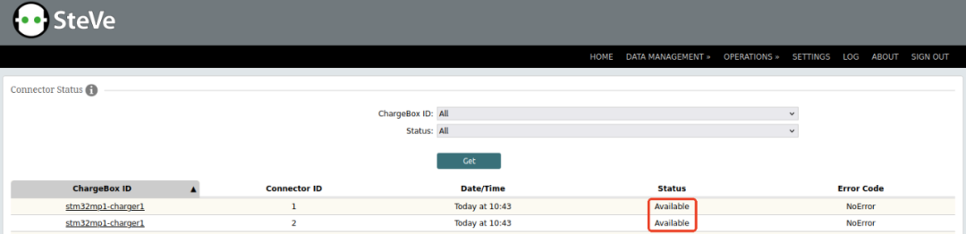

通过操作GPIO电平变化模拟充电枪插拔过程,我们观察到客户端实时向服务器上报状态变更。
root@myd-yf13x:~/Microocpp# echo 0 > /sys/class/gpio/PI7/valueroot@myd-yf13x:~/Microocpp# [MO] info (StatusNotification.cpp:52): New status: Available (connectorId 2root@myd-yf13x:~/Microocpp# echo 0 > /sys/class/gpio/PC13/valueroot@myd-yf13x:~/Microocpp# [MO] info (StatusNotification.cpp:52): New status: Available (connectorId 1)
服务器界面同步更新连接器状态,证明整个通信链路工作正常。
电动汽车
充电枪可用状态
