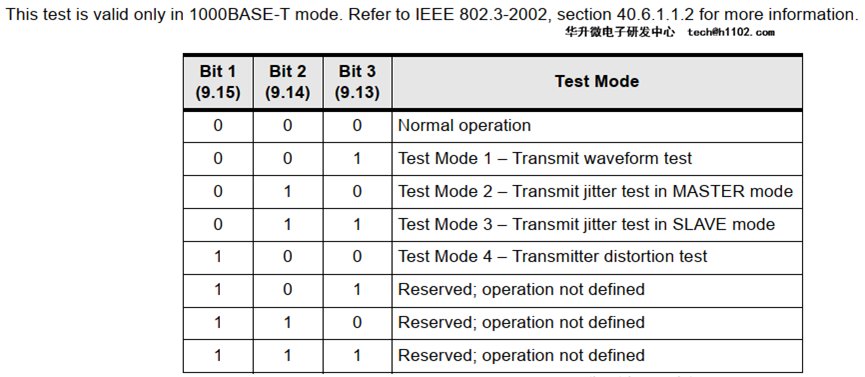

二:PHY芯片测试模式介绍

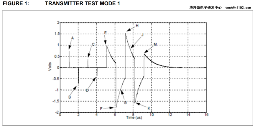

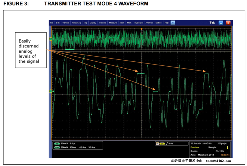

常用的测试项只需要用到模式1跟模式4,测试时候,按照对应测试项,软件上发指令让PHY芯片进入对应的模式即可,芯片就会对外发送特定的波形,示波器设置好参数,软件就会自动采集分析,只需要等待结果,输出报告即可。
• Test Mode 1: The PHY repeatedly transmits the following sequence of data symbols from all four transmitters:{{"+2" followed by 127 "0" symbols}, {"-2" followed by 127 "0" symbols}, {"+1" followed by 127 "0" symbols}, {"-1"followed by 127 "0" symbols}, {128 "+2" symbols, 128 "-2" symbols, 128 "+2" symbols, 128 "-2" symbols}, {1024"0" symbols}}. The transmitter should use a 125.00 MHz ± 0.01% clock and should operate in MASTER timing mode.
• Test Mode 2: The PHY transmits the data symbol sequence {+2, -2} repeatedly on all channels. The transmitter should use a 125.00 MHz ± 0.01% clock in the MASTER timing mode.
• Test Mode 3: The PHY transmits the data symbol sequence {+2, -2} repeatedly on all channels. The transmitter should use a 125.00 MHz ± 0.01% clock and should operate in SLAVE timing mode.
• Test Mode 4: The PHY transmits the sequence of symbols generated by the following scrambler generator polynomial, bit generation, and level mappings。
