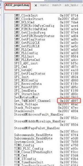

**5.1 **程序中全局数组地址为奇数地址,未四字节对齐
打印内容:
"MTVAL:0xeeeeeeee/r/n MEPC :0xeeeeeeee/r/n"
RISC-V
修改方式:
typedef** attribute ((aligned(4))) uint16_t AlignedUint16_IAR;**
void****MapADCTempResultsToArray( AlignedUint16_IAR Set_74HC4067_Channel[TEMP_SENSOR_COUNT])
