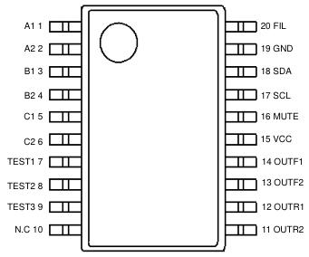

引脚配置与描述
引脚配置图
声音处理器
引脚描述
Pin No. Pin Name Description Pin No. Pin Name Description
1 A1 A input terminal of 1ch 11 OUTR2 Rear output terminal of 2ch
2 A2 A input terminal of 2ch 12 OUTR1 Rear output terminal of 1ch
3 B1 B input terminal of 1ch 13 OUTF2 Front output terminal of 2ch
4 B2 B input terminal of 2ch 14 OUTF1 Front output terminal of 1ch
5 C1 C input terminal of 1ch 15 VCC Power supply terminal
6 C2 C input terminal of 2ch 16 MUTE External compulsory mute terminal
7 TEST1 Test Pin 17 SCL I2C Communication clock terminal
8 TEST2 Test Pin 18 SDA I2C Communication data terminal
9 TEST3 Test Pin 19 GND GND terminal
10 N.C. No Connection 20 FIL VCC/2 terminal
