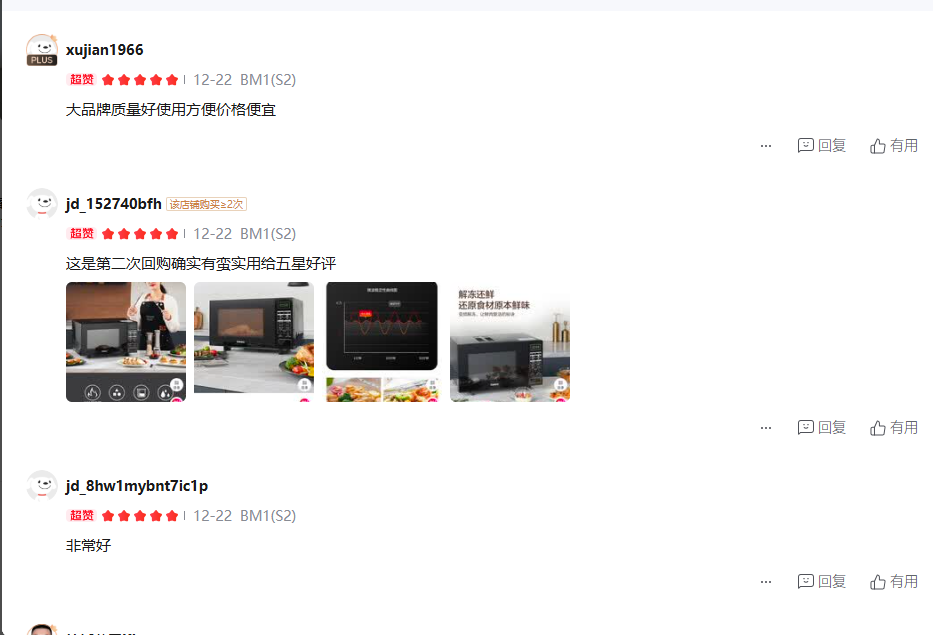

        "real_total_results": 500000,
        "total_results": 500000,
        "page_size": 10,
        "page": "1",
        "item": [
                "rate_content": "大品牌质量好使用方便价格便宜",
                "rate_date": "2025-12-22 14:10:35",
                "pics": [],
                "rate_id": "103553730157088578",
                "guid": "T6NdPMJ0j58tdR-BW66QxXiJ",
                "score": 5,
                "display_user_nick": "xujian1966",
                "auction_sku": "BM1(S2);",
                "add_feedback": null
                "rate_content": "这是第二次回购确实有蛮实用给五星好评",
                "rate_date": "2025-12-22 14:04:22",
                "pics": [
                    "jfs/t1/375305/12/20041/261755/6948df61F9fd28fd4/00a94ecaf014c703.jpg",
                    "jfs/t1/376768/4/18439/269304/6948df65F5fed58df/00a94ecaf00b6fbc.jpg",
                    "jfs/t1/379944/35/12289/321964/6948df64Fe0093753/00a94ecaf06eea35.jpg",
                    "jfs/t1/373946/31/20633/335073/6948df62Ff02f42fe/00a94ecaf0921005.jpg"
                "rate_id": "103543710155619542",
                "guid": "T6NdPMN0j50tdR-DXaeRxXuD",
                "score": 5,
                "display_user_nick": "jd_152740bfh",
                "rate_content": "非常好",
                "rate_date": "2025-12-22 12:58:29",
                "pics": [],
                "rate_id": "103541160162348180",
                "guid": "T6NdPMN2iZotdRyEWKKQwXeB",
                "score": 5,
                "display_user_nick": "jd_8hw1mybnt7ic1p",
                "rate_content": "好用的,经常回购,下次继续回购,推荐",
                "rate_date": "2025-12-22 12:31:51",
                "pics": [],
                "rate_id": "103045080228559127",
                "guid": "T6NdOcNyiJQtdhiOXqORwX2G",
                "score": 5,
                "display_user_nick": "扶摇公子Kiss",
