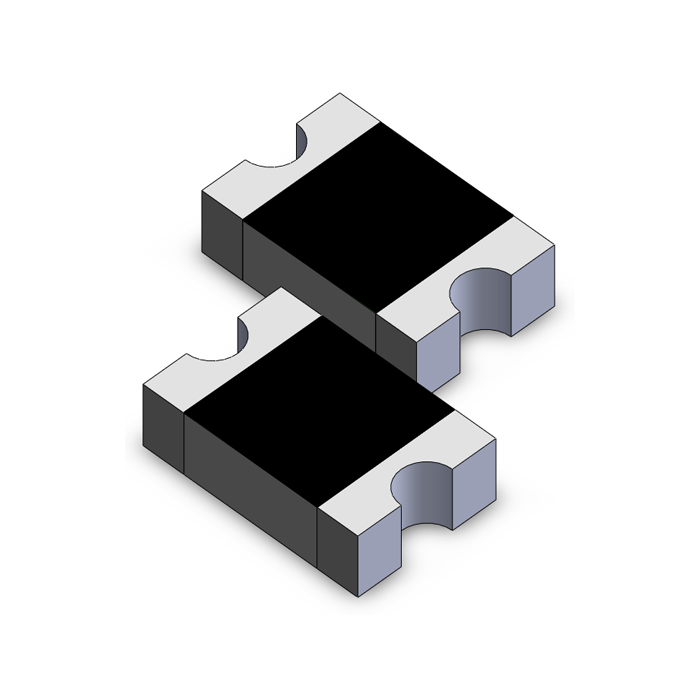

PPTCPPTC贴片自恢复保险丝

PPTCPPTC贴片自恢复保险丝
