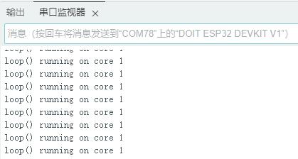

查看ESP32当前哪一个内核在执行任务
打开Arduino IDE并给ESP32上传如下代码
调用xPortGetCoreID()函数,可以获取内核号
void setup() {
  Serial.begin(115200);
  Serial.print("setup() running on core ");
  Serial.println(xPortGetCoreID());
void loop() {
  Serial.print("loop() running on core ");
打开串口监视器即可查看ESP32当前内核1正在执行任务

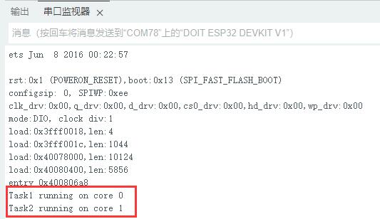

双核同时执行任务
TaskHandle_t Task1;
TaskHandle_t Task2;
// LED pins
const int led1 = 2;
const int led2 = 4;
void setup() {
pinMode(led1, OUTPUT);
pinMode(led2, OUTPUT);
  //create a task that will be executed in the Task1code() function, with priority 1 and executed on core 0
  xTaskCreatePinnedToCore(
                    Task1code,   /* Task function. */
                    "Task1",     /* name of task. */
                    10000,       /* Stack size of task */
                    NULL,        /* parameter of the task */
                    1,           /* priority of the task */
                    &Task1,      /* Task handle to keep track of created task */
                    0);          /* pin task to core 0 */
  delay(500);
  //create a task that will be executed in the Task2code() function, with priority 1 and executed on core 1
                    Task2code,   /* Task function. */
                    "Task2",     /* name of task. */
                    &Task2,      /* Task handle to keep track of created task */
                    1);          /* pin task to core 1 */
    delay(500);
//Task1code: blinks an LED every 1000 ms
void Task1code( void * pvParameters ){
  Serial.print("Task1 running on core ");
  for(;;){
    digitalWrite(led1, HIGH);
    delay(1000);
    digitalWrite(led1, LOW);
    delay(1000);
//Task2code: blinks an LED every 700 ms
void Task2code( void * pvParameters ){
  Serial.print("Task2 running on core ");
  for(;;){
    digitalWrite(led2, HIGH);
    delay(700);
    digitalWrite(led2, LOW);
    delay(700);
void loop() {
本代码实现在内核0上执行让LED1每1000ms间隔闪烁,在内核1上执行让LED2每700ms间隔闪烁。两任务的优先级都为1,同时执行,并在串口监视器上打印出内核信息。若不开启双核执行,采用默认的单核顺序执行,就不能让LED1和LED2同时以不同的间隔闪烁。
