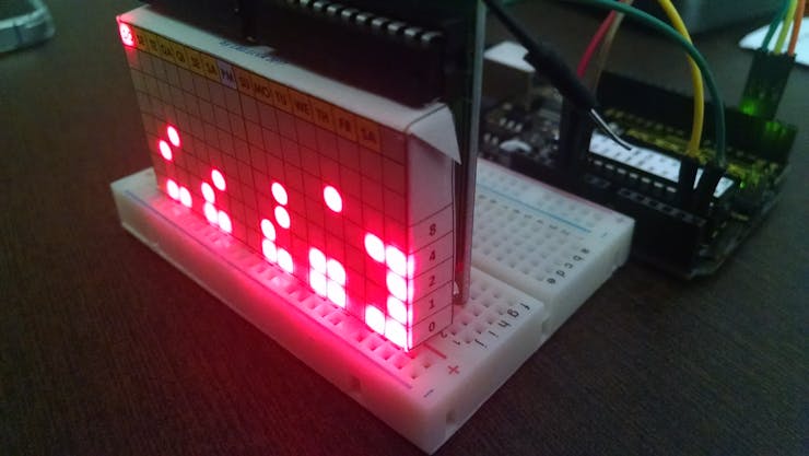

img_20171224_161959116_oIalrY5Ejd.jpg?auto=compress%2Cformat&w=740&h=555&fit=max
二进制时钟 - 纸模板侧面阅读的详细信息
